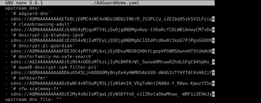

Don't understand why it works for me...
Can you give me the output of this command, please:
sed -ne '/upstream_dns/,/upstream_dns_file/p' /opt/kamoj/addons/defaults/AdGuardHome.yaml

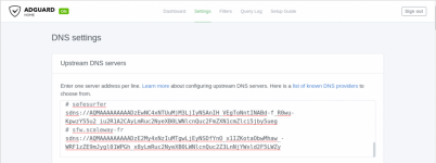

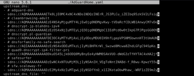

Hello,
Excellent thought - I wondered about looking at the outputted server list but didn't trust my feeble skills any further. I have attached a file showing the output of the command. The file shows each commented line looks like this (with server dns stamp below):
'# My Comment'
sdns://blahblahblah
I am guessing that is what you expected to see? I don't know how how to properly correct this but changing
'/^[[:space:]]*#/d'
to
'/[[:space:]]*#/d'
in the line below (from addon_info_update.sh) does give me the correct server count on the Router Information Page.
dns_servers="DNS Servers: $(sed -ne '/upstream_dns/,/upstream_dns_file/p' /opt/kamoj/addons/defaults/AdGuardHome.yaml|sed -e '/^[[:space:]]*$/d' -e '/^[[:space:]]*#/d'|awk '!seen[$0]++'|wc -l|awk '{print ($1-2)}')"
I hope this helps - and thank you for looking into this for me.

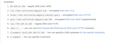

Hello,
Thanks for the link to the yaml tutorial! I reviewed it but could not see anything I did that may cause the problem. I edit the server list (and comments) from the AGH Settings/DNS Settings web page accessed via the link in the Kamoj Add-on (I never edit the config file directly like I would with DNSCrypt). I never use single quotes in the comments and simply start each comment line with a "#" symbol, like this:
# Example Comment
I then hit "enter" on my keyboard to start the next line
Yet when I opened the file /opt/kamoj/addons/defaults/AdGuardHome.yaml, there were single quotes in front of each DNS server list comment. Since I did not add them, I thought AGH must do so. To check further, I manually deleted the single quotes within /opt/kamoj/addons/defaults/AdGuardHome.yaml and saved the file. I opened it again to confirm no single quotes.
I then went back to the AGH DNS Settings web page and entered more comments and server stamps. I clicked "Test Upstreams" - all was OK. I then saved the updated list via the "Apply" button.
I rechecked /opt/kamoj/addons/defaults/AdGuardHome.yaml.. and the single quotes were back for both the old comments and the new ones! At this point I assume AGH formats the list when you hit "Apply". I have tried using spaces before and after the comments and no spaces before and after the comments, etc, but I get the same results.
Am I doing something wrong with how I set up the list? I have attached pictures of the applicable sections of the AGH Settings/DNS Settings web page and of the server list (with the AGH added single quotes and my file with the quotes removed) from the AdGuardHome.yaml file. If I have not done my set up incorrectly, can the Add-on be configured to ignore the single quotes (or look for them instead of # at the beginning of a line) when looking for AGH server comments? Since removing the caret ^ symbol in the code of "addon_info_update.sh", each server change has been counted correctly.
Thank you,
BL

Hello,
# Example Comment
Thank you,
BL
Thank you again for all help!
No, you're not doing anything wrong.
But I don't understand what the Adguard team is up to...
I'll do some fix for this of course, even though not as you suggest as that will have other implications for other users/usage.
