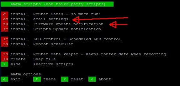

Thank you very much, I have installed it and it did indeed set it up to my USB, great stuff.
As regards email notifications, in the FAQ you note:
"Email notifications if you configured email options in AMTM."
"This menu item will be displayed only IF the "Email Notifications" setting has been ENABLED; otherwise, it's hidden.)"
For clarity please, as the amtm menu ew "email settings" does not appear verbatim in the FAQ, the latter which refers to "Email Notifications".
I ask as there is actually a menu for "Firmware update notification" so wanted to make sur eit is "em", which I 99% believe to be correct?
i.e. I assume you mean "em" (same menu code as in amtm/MerlinAU) and not "fw", the Firmware update notification.
The option in AMTM is "em" to configure email notifications. :)
I'm pretty sure the Firmware update notification script is for people who only want notifications without the auto-update.
It would only send an email. Which you would need to configure the "em" option in AMTM anyways for the "fw" to function. At least that's always how I pictured it working.
(The @thelonelycoder can correct me here if I'm wrong, I actually haven't installed it and have no connection to that firmware update notification script)
The "em" option seems to work for MerlinAU :) thanks.
