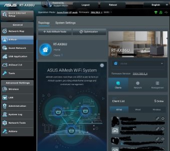

Here's a partial screenshot showing the WebGUI page mounted & working fine on a router operating as an AP.

Does the menu option show on an AP?
If so and you load the menu, do you see the AP itself, other APs/nodes or nothing? If it loads other devices, does it include the primary router?

Did you have the Ai Mesh Nodes menu on the AP?

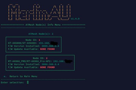

Yes. I believe all APs have the Ai mesh Nodes menu
Yes. It shows the other two nodes including the router
Thanks for testing and confirming; we will likely block this from functioning on the AP.
Really the AP should be considered/treated the same as an AiMesh node to MerlinAU shell script. (With the exception of mounting the WebUI)
