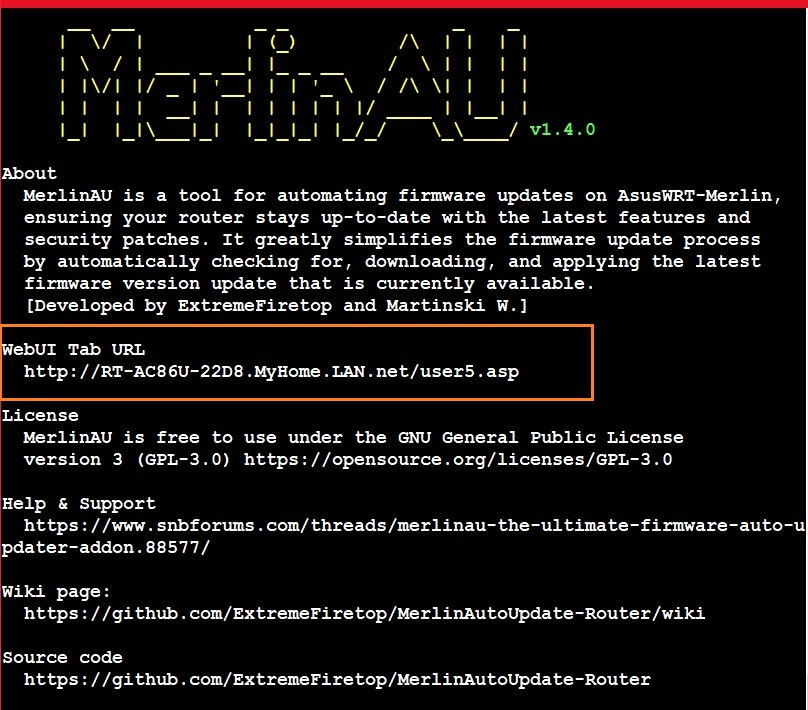

PR: [ #426] - Improvements to support APs
  • (This was to address a concern of mine where an AP would show the AiMesh nodes menu and run in "Primary router" mode.)
  • Martinski made changes so that we can handle specific functionality or features based on whether the router is operating in "Router Mode" (i.e. Primary router) or in "AP Mode."
  • This allows us to determine whether the WebGUI should be mounted or whether the AiMesh nodes should be handled only by the Primary router.
  • Added WebUI Tab URL info to the CLI "About" page.
  • (Thanks @Martinski4GitHub @Martinski)

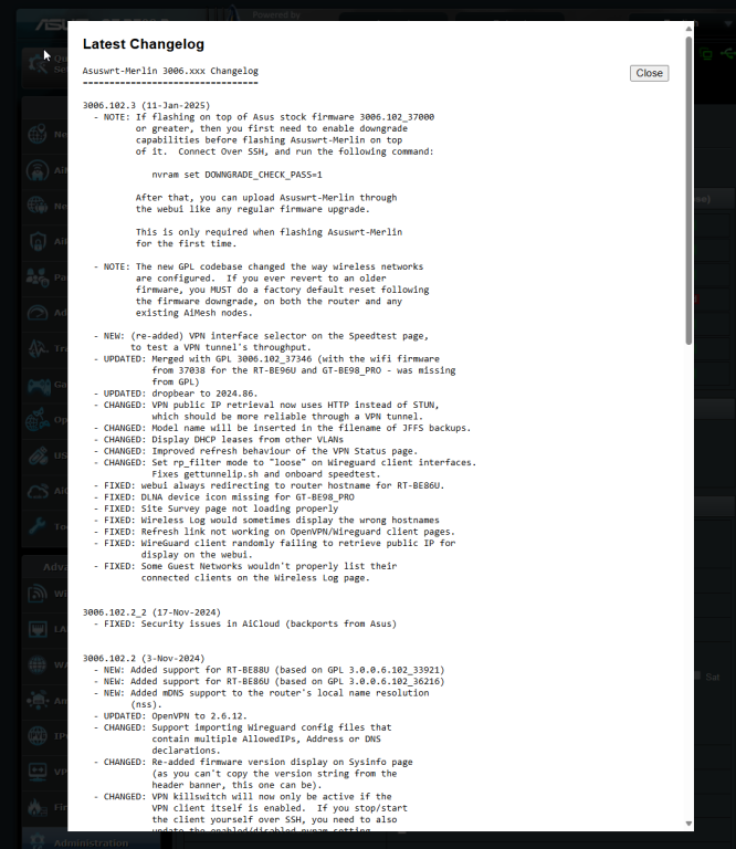

  • I changed the visuals of the "Latest Changelog" button in the WebUI at the request of @vlord
  • The process is more or less the same, but it will now open in an overlay instead of a new window, and won't display as though it's applying any setting.
