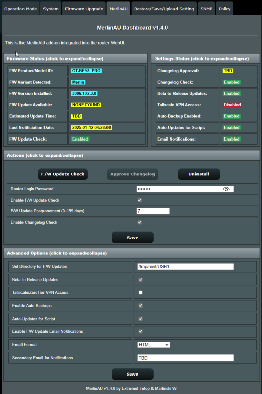

Martinski and I reached a new milestone yesterday which was having my router flash to the latest firmware from the WebUI; no CLI/SSH needed.
Still no ETA; but progress is moving along and improvements are being made and bugs are being identified and fixed as we go!
Here is another preview below with no updates found:
And one with an update found:
Still not ETA; but progress is moving along and improvements are being made and bugs are being identified and fixed as we go!

With all that said, here is the next preview screenshot of the WebUI:
Once 1.3.10 is out in the wild/production, we will start beta testing 1.4.0 with the WebUI in the developer branch.
