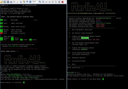

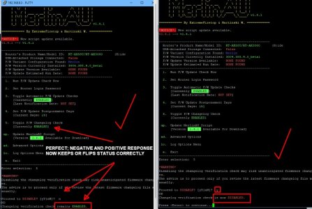

... please test with the same command and advise if the fresh install functions better:...
You seem to have nailed it :-). Couldn't make it fall over...
Can I request you test once more, without using the install parameter? To confirm that it's not a requirement for a fresh install.
Thank you for testing!
Sorry what was the install parameter please?
I just used the curl line, then went into amtm and 1.4.1 was there?
Also; complete uninstall again first, right?
Oh perfect. Fantastic that's confirmation enough! The install parameter was this message:
Sorry it didn't get tagged as code in the last reply:
sh /jffs/scripts/MerlinAU.sh install
Great! My work here is done :-). I am off for a run to clear my head ...
sh /jffs/scripts/MerlinAU stable
Thank you, threw a wee error until I found a previous post in this thread, which had an extra .sh in it.
For completeness and anyone looking it is:
sh /jffs/scripts/MerlinAU.sh stable
i.e. don't forget the .sh after MerlinAU :-).

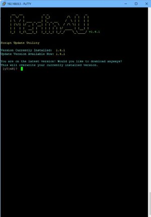

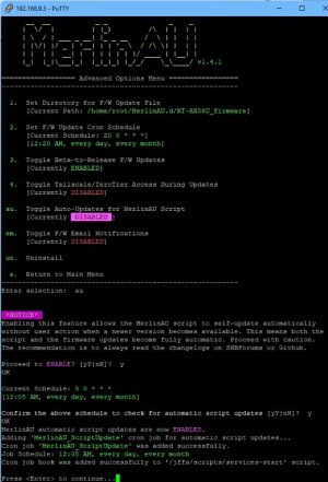

1. amtm, 8, ad, uninstall (y), keep (n)
2. exit amtm
3. run curl install
curl --retry 3 "https://raw.githubusercontent.com/ExtremeFiretop/MerlinAutoUpdate-Router/refs/heads/dev/MerlinAU.sh" -o "/jffs/scripts/MerlinAU.sh" && chmod 755 "/jffs/scripts/MerlinAU.sh"
4. go into amtm, shows MerlinAU 1.4.1 select 8; no update shown at this point!
5. Ran Router Login Password and Test Ok (Still needs a Message [RouterCheckOK] :-))
6. Ran up, it shows I am on 1.4.1; and 1.4.1 is the latest; BUT
7. If I say (n) it goes back to the menu and (incorrectly) shows there IS an update; AND
8. If I say (y) it updates, goes back to the menu and (still incorrectly) shows there IS an update.
9. BUT if I then run up AGAIN (y or n), there is no update? Did you do a sneaky 1.4.1 fix while I was doing this :-)?
HTH
k

Hi @jksmurf
Unfortunately Martinski couldn't quite put his finger on that report; but after a bit of translation and back and forth with him; I think I got something to fix your issue.
Please try again and let me know if it happens again.
Hi @jksmurf

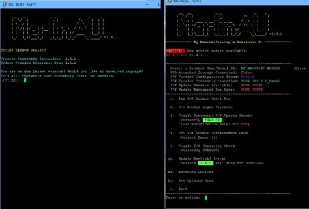

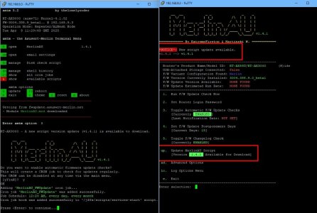

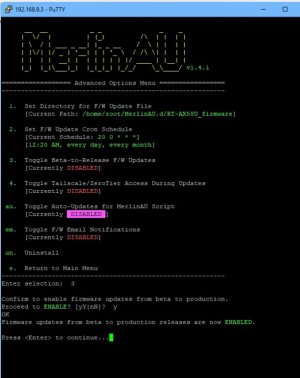

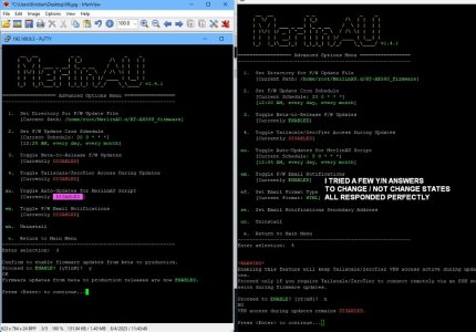

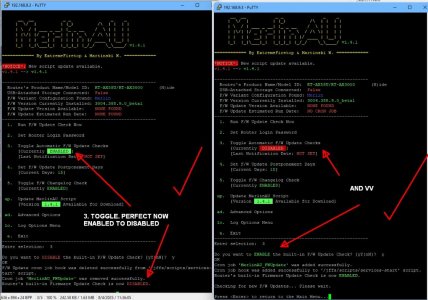

I think you cracked it (thankfully, I was starting to get to the end of the cheese block and contemplating running out of crackers...)
Sequence checked
2. exit amtm
3. run curl install
4. go into amtm, shows MerlinAU 1.4.1 select 8; no update shown at this point, as expected
6. Because I am on a cheese high, I also ran the FW Check, Email Test, and set the Auto-Updates for the MerlinAU Script
7. Eventually got bored with everything working, so I ran up, it shows I am on 1.4.1; and 1.4.1 is the latest as before ... with the message "You are on the latest version! Would you like to download anyways?". The superfluous 's' at the end of anwyay made me want it to fail (TIC), but alas, it all worked
8. If I say (n) to update anyway (no s) it goes back to the menu and (correctly) shows there is no update
9. If I say (y) it force updates, goes back to the menu and (correctly) shows there is no update
10. If I then exit MerlinAU, then amtm, go back in again and run up again (y or n), same correct answers
I will now go hunt down some red wine for my remaining cheese...
HTH
k.

MerlinAU 1.4.1 Released!
What's Changed/Fixed?:
PR: [ #[443] and #[444] - Attempted Bug Fixes for Fresh Installs
-Modified code to add missing Install Parameter for Script
-Attempted to move some logic around. Was eventually superseded by Martinski's PR's 445 below
PR: [ #445 ] - Code Improvements for Downloads
-Modified code to check and make sure the WebGUI ASP file is downloaded and installed.
-Modified code to check and make sure all configuration default settings are initialized.
(Thanks @Martinski4GitHub )
PR: [ #447 ] - Check for Version File
-Added a check for the version.txt file.
PR: [ #448 ] - Fine-tuning Code
-Moving some functions and logic around
PR: [ #449 ] - Patch Update Process
-Resolved some issues causing reports of having to run the update process twice, or reports of incorrectly identified updates.
Issues reported by @vlord here: https://www.snbforums.com/threads/m...auto-updater-gnuton-support.91326/post-950588
And here: https://www.snbforums.com/threads/m...auto-updater-gnuton-support.91326/post-950593
And @jksmurf here: https://www.snbforums.com/threads/m...auto-updater-gnuton-support.91326/post-950590
And here: https://www.snbforums.com/threads/m...auto-updater-gnuton-support.91326/post-950749
As always, we highly recommend you update ASAP as this includes important functional improvements and bug fixes.
