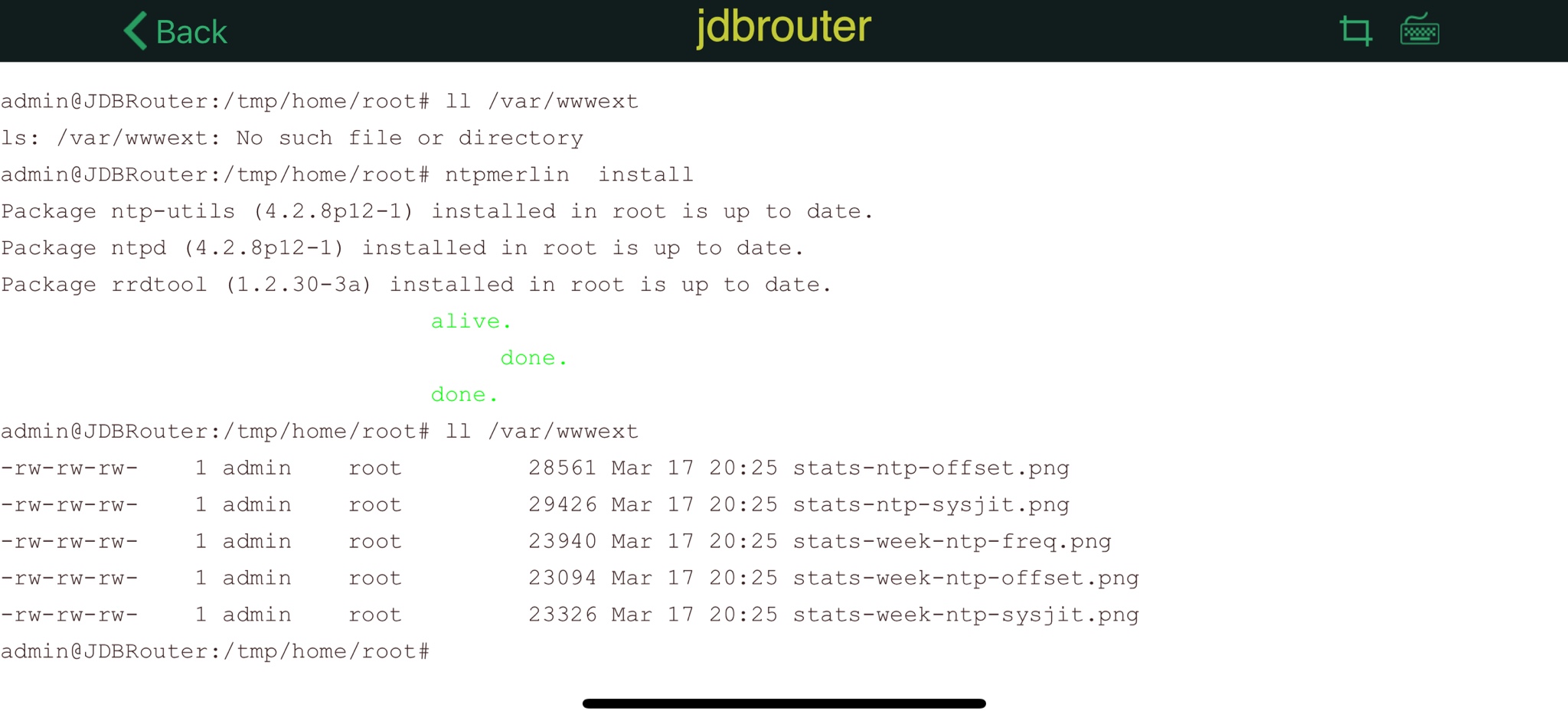

Page appeared but no images
Debugged to;
admin@JDBRouter:/www# ll ext
lrwxrwxrwx    1 admin    root            11 Dec  8 19:12 ext -> /var/wwwext
admin@JDBRouter:/www# ll /var/wwwext
ls: /var/wwwext: No such file or directory
admin@JDBRouter:/www# ll /tmp/var/wwwext/
drwxr-xr-x    2 admin    root             0 Jan  1  1970 cgi-bin/
So my symbolic link points to /var but the actual wwwext is in /tmp/var
Guessing you must have updated that symbolic link somehow bit not included it in the install?
I skipped the symbolic link and images get written directly to /www/ext
Can you check if that dir exists?
What does
ls -la /www | grep ext
show?
That’s my point, my /www/ext is a sym link to /var/wwwext which doesn’t exist!

Fixed in 1.0.2
Should be fixed in 1.0.1
Ran update and got v1.0.2
Still no fix
Ran install
And it says can’t mkdir ‘’ (i.e. blank)
Still no fix
Ran install
Darn you grabbed the broken 1.0.2
run uf at the menu
(if that doesn't work then there's probably github caching in play, the fix is on line 291, remove the -f switch from readlink)
run uf at the menu
Claimed it re-updated to 1.0.2, I ran install again but still no dice, same error
Probably caching, I'll bump version to 1.0.3 (ive tested rm'ing directory and it gets created)
EDIT: 1.0.3 is now pushed
EDIT2: if still no dice, what does
readlink /www/ext
return?
readlink /www/ext
return?
Sorted [emoji106]
