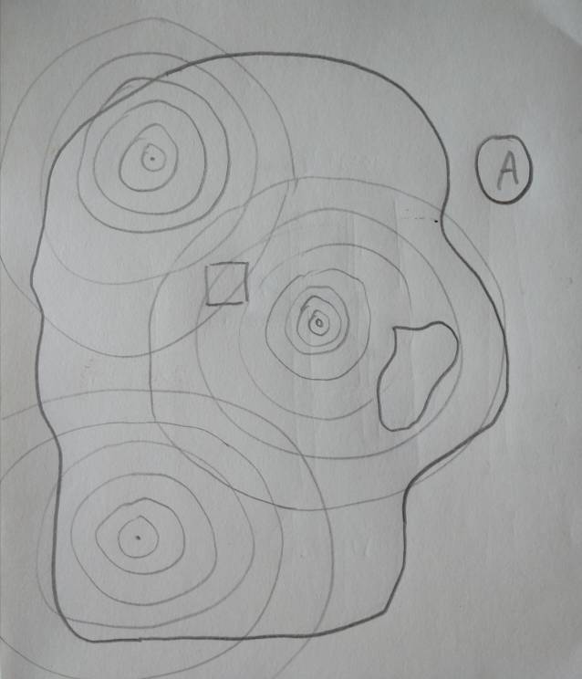

This is the layout of the property:
And this is what I've decided to do:
where 4 APs with directional antenna will broadcast outwards, in directions 1, 2, 3 and 4 and, internally, 5 AP will broadcast 360° inside each room.
If clients will not be able to send packets back sufficiently well and if I will not be able to see good throughput, then I will leave the 5 internal APs as they are and I will reposition 3 or 4 of the external APs as you suggested:
I want to try to avoid having to lay underground cables but... I might not have a choice.

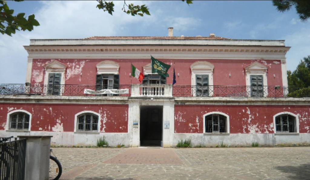

This image only shows the balcony layout and how simple the building plan is but the structure itself is much much older and made of thick stone, not bricks:

It is a challenge for a real network of professionals with great knowledge of WIFI in such an environment, It's something else then the buildings of plaster walls that a home user can handle.
Here is a UniFi install for a castle and a B&B, the environment you have requires a proper planning from a professional who knows what he doing to get the best solution.
Its a real challenge belive me.
