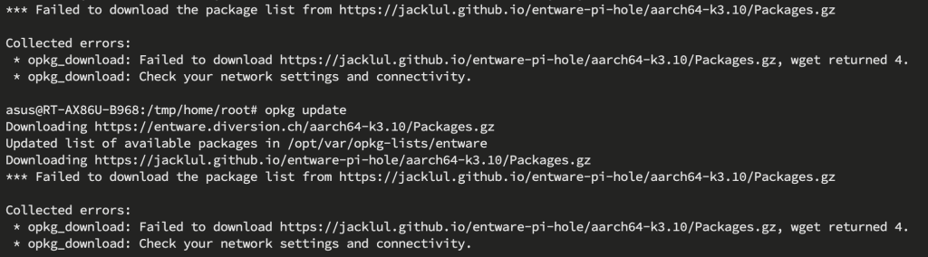

I am getting errors acessing the opkg update:
