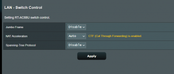

These are my settings:
I have the same problem with an AC68-U router and last firwmare 386.2.
If I disable NAT Acceleration it works fine but limits the bandwidth. (I have 1GB symmetric).
If I enable it, the WhatsApp calls do not work (for a few seconds I can listen but they do not hear me, after 10 seconds the call is cut off).

I have tried to enable and disable various parameters such as:
SIP Passthrough
RTSP Passthrough
Without success, it only happens in Whataspp, the other type applications (telegram, skype, teams, etc.) works correctly.
I have had this problem for about 6-7 months, with the latests firmwares.
The provedoor of internet is DIGI is Spain
