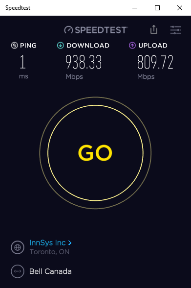

You got fiber right to the ONT. Or you still using coax to the modem ?? True fiber connection will have no coax cable. As stated it don't matter if it works it works. :)
You are making a ton of assumptions without knowing anything about the ISP been used. And you are talking to someone that does IT for a living. I have direct Fiber to my unit which is FTTH. This isn't FTTN there is no coax cable coming into my unit.
You will never see someone using a FTTN connection that has coax coming into their unit that has 750mbps uploads. At least not with current Coax technology.
You will also never see 1ms times on a FTTN / Coax connections.

The connection is 1000/750 GPON fiber not Cable.
Its rare to find a cable connection offering more than 50mbps on the upload the bandwidth just isn't there until they release docsis 3.1 on the upload side and that will improve the speeds but still not give you full symmetrical on cable. You have to wait for Full Duplex cable for that which is many years away still.
Yeah I asked the question about your connection because many people in Canada have "Bell Fibe" which can be assymetrical VDSL2 (or something like that) and they think it's fiber :)
Since you have actual GPON fiber I am guessing you live in a condo building in the downtown of a major metro?
I live in downtown Toronto so you are correct on that :)
And ya bell's marketing is confusing for none technical people. So you have people on DSL connections that think they are on actual fiber.
You will also never 1ms times on a FTTN / Coax connections.
Right on @Makaveli you know your stuff. My cable company DOCSIS 3.0 latency is 17 ms. I have 24 download channels but only 4 upload channels (my cable modem is a 24x8 but the cable company only provisions 4 upload channels). So very asymmetrical. It is pretty OK but absolutely fiber has way less latency and typically is provisioned symmetrically or close to it.
