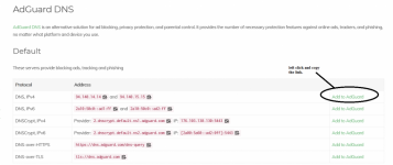

If you want to change what dns servers you are using, in the first post I provided details of where to do that
Here is a list of servers
If you right click and copy the link provided by the webpage that says Add to AdGuard.
it will provide you with a sdns:// format that is easily portable to AdGuardHome upstream server section.
Example:
sdns://AgcAAAAAAAAAAAAPZG5zLmFkZ3VhcmQuY29tCi9kbnMtcXVlcnk
which is for AdGuards default DoH service.

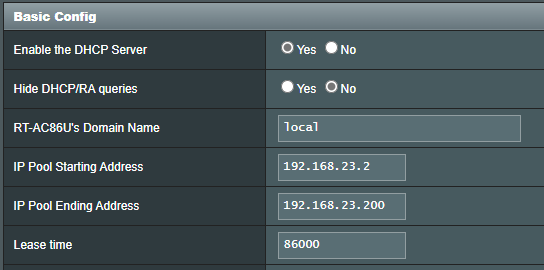

@SomeWhereOverTheRainBow One more issue I noticed. Before AdGuard, my local domain resolution was working with just hostnames. e.g. nslookup raspberrypi. But with AdGuarad it did not work.
$ nslookup
> raspberrypi
Server:         192.168.23.1
Address:        192.168.23.1#53
** server can't find raspberrypi: NXDOMAIN
I had to add my local domain in Upstream section (which you already add in Private reverse DNS servers section). So my current DNS setup is as below, which is providing valid local lookups.
$ nslookup
> raspberrypi
Address: 192.168.23.15
Reading their documentations your implementation should have worked. Not sure if my network is any different since no one else have reported this issue.
$ nslookup
> raspberrypi
$ nslookup
> raspberrypi
That depends on your setup. I was able to use the current arpa just fine. Not everyone has .local at the end of their raspberripi.
Mine is .mydomainname. If you want to resolve the issue, you need to set your routers domain to local, or modify your raspberrypi accordingly to your domain name.
At any rate you are using the wrong spot for defining a local request. It should be done in the Private reverse DNS servers. Using the upstream section has been known to break things at some point. AdGuardHome Devs only want you to use the upstream section if you are planning to send ALL your arpa. request to that. Otherwise you are leaking local client information to the upstream.
I already have it since very beginning, I didn't change that for adbloker. This along with installer adding the - '[/$DOMAIN/]$(nvram get lan_ipaddr):553'" \ part should cover my case, right?
I beg to differ here.. Per their code, if a domain is specified (e.g. [/local/]192.168.23.1:553) then all requests for that domain should only go to that upstream, dnsmasq in this example. So I am not leaking local client info to any other upstream. Also the "Private reverse DNS servers" is section is kind of misnamed. Its used for PTR requests, which is more of dig than nslookup, right? I cam across https://github.com/AdguardTeam/AdGuardHome/issues/3028#issuecomment-830246459 which seems to agree with my reading. Any way I added two entries in upstream, and all my tasmota client who were configured to talk to my pi are happy. btw // has the special meaning of “unqualified names only”, i.e. names without any dots in them, like myhost or router.
[//]192.168.23.1:553
Maybe this was the case before v.0.106.0, but currently all private lookups must be handled by the private reverse DNS servers. otherwise defining private in the upstream means that local lookups may be sent to local or they maybe sent to upstream as well. while upstream look ups can be sent to local and upstream.
After thoroughly reviewing, the issue lies more in their documentation then anything. I will push a patch.
Now all private domain request will be handled in the upstream section.

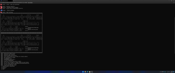

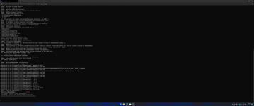

Clean install of 386.4, I ssh into the router and install EP and then AdBlock, but it just gets caught into a circle of installing. It clears the screen before I can grab the errors. Is there a place I can grab logs to show you guys?
Is it a good idea to fresh install adguard at every new update? Clear out any old setting? This seem to have work for me just incase come minor code change which need the old setting to clear out?
You can if you Iike to. The only differences are all the domain associations in the private dns section for moved from there to the upstream section while all the arpa. got left in the reverse dns section.
Scroll up your ssh terminal and screen shot, that is the best log as everything can be seen there.
