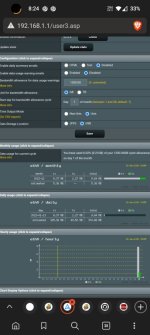

May I know exactly what did you do to fix that issue?
I tried to to run those 2 commands in ssh
opkg remove vnstati2 libgd
opkg remove vnstati2 libwebp
And install again
No success
Still have December 2022
And install again
No success
Please describe:
- Router model (note the supported models in the first post)
- Firmware version (note the minimum required version in the first post)
- Other installed add-ons
- Are any other add-ons having problems
- Have you tried a force-update? (You should not lose any data)
- Have you tried a reboot? (You should not lose any data)
