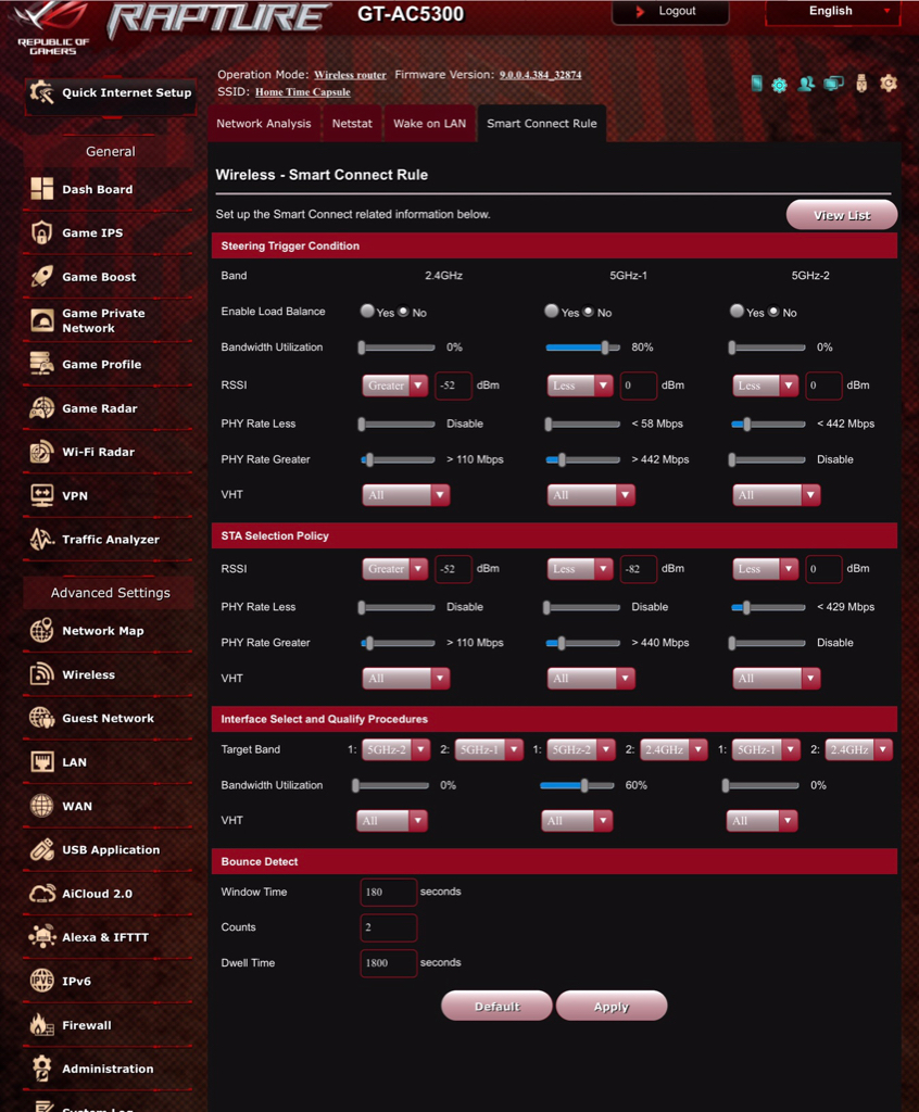

Here is my Smart connect, does this look ok?
There are some REALLY good articles about SmartConnect here on SNB. Do a bit of a search and you'll get a great primer on this feature.
To me, however, SmartConnect is TOO smart. And exposes TOO many settings. I recommend avoiding SmartConnect. Why not designate different bands for different needs and allow specific devices to connect to those bands?
