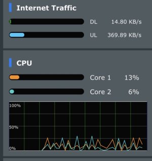

My AC86u router has been randomly restarting recently, with consistently high CPU usage. It only has the amtm's LED SWITCH CONTROL installed and an OPENVPN service running. I have noticed many kernel errors in the logs.The log is provided below.

I understand! However, I am currently unable to determine the exact cause. Previously, my AC86U router's temperature ranged between 158-194°F without a fan, but after adding a fan, it stabilized around 138-144°F. The memory usage at idle is about 70%-80%. If I enable Samba, the available RAM drops to around 90MB.
Can these observations indicate whether it is a hardware issue? If not, are there other methods to diagnose the problem that don't involve physically modifying the router?
