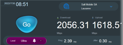

I can tell you the AX86U is good for about 750-850 with Adaptive QoS when I tested it last. I don't have issues that require QoS so I leave it off, that testing was a couple firmwares ago. So the AX6000 may get you close and has 2 2.5 Gb ports.
Yeah, that even works up to 850 MBit. Steam completely overwhelms it, though, causing increasing packet loss.
