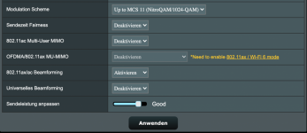

After tinkering and testing around for Month's I've found the nearly perfect Wi-Fi settings for me.
Feel free to try and adjust them. Feedback appreciated.
2,4 GHz
Why would you explicitly disable beamforming? Just curious as I'm looking to "upgrade" from a TP-Link Archer C2600 (AC 3x3) on KONG OpenWRT to an AX-58U with Merlin firmware.
Adjusted some of my Settings since Dec 2020. This is my current Setup, and it runs pretty good, at least for me.
Recommendation for Beamforming -> http://www.snbforums.com/threads/beamforming.41417/post-494528
Please adjust the Beacon as you like, my devices work pretty well with 200. (Screens show 300, but I'm using 200 now for both)
2,4
