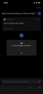

Hi Martineau, all of a sudden the wg_manager doesn't work in siri shortcuts. not sure what changed... thanks
