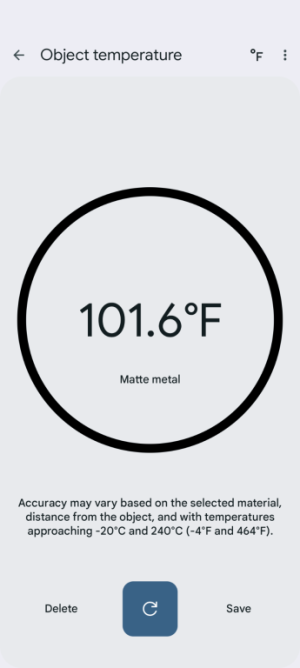

BTW- One of my U7 Wall units is in a small cabinet in a family room along with the PoE adapter. I don't know where to look for temps yet, but by feel and by opening the door to the cabinet, nothing unusual.

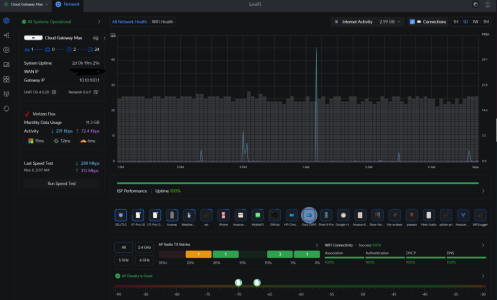

A clip of the dashboard
