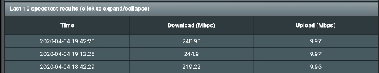

Could I ask for speculation on some results I am seeing in the automated speed tests since I changed the way QoS was set up?
I have a scheduled backup that backs up my Synology NAS data to my iDrive account, starting at 6:30 AM each day. What I am not sure about is the fact that the speed test graph drops right down at 6:42 each morning (the backup is still running at that time, usually backing up my daughter's games files at 6:42 according to the iDrive logs). I'm just curious as to why this should be happening and whether it indicates that FreshJR QoS is working properly or the opposite. I'd be interested to hear what those who know about these things make of the results I am getting. I'm uploading the speed test results + a screenshot of how I have QoS set up at present (based on 60 Mb/s down and 15-17 Mb/s up without QoS enabled).

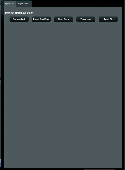

@Jack Yaz, I recently installed the script and it seems my speed test are backwards, the WAN shows what my VPN speeds should be:
Any idea why this might happening?
UPDATE: I figured it out, I had the cat5 cable connected to port 2 of the CM1150v modem, which was for some reason messing with speeds.

I noticed that all the speed test graphs had disappeared this morning and even running a speedtest from within the GUI after rebooting my RT-AX88U (running beta 3) didn't make any difference. I then carried out a speed test through amtm and when I re-checked, the speed test graphs had re-appeared. However, two of the upload graphs don't seem to be agreeing with each other. The monthly graph is showing the same dips in upload speed at 6.42AM that I was getting on the daily graphs, but the weekly graph is now showing something different.
that's strange, it could be a side effect of whitelisting upload in QoS. has it stabilised since your post?
It seems to have done. One odd thing though - the upload speed has increased.
