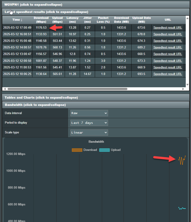

I am somewhat skeptical of the results reported for the WG clients however as WG client 1 reports approximately the same download speed as OpenVPN 1 client and the servers for both are in a city 200 miles distant.
Actually in my case OpenVPN is just slower, Wireguard is almost always faster for me.
What is even harder to believe is that WG Client 5 which is in a city 4,500 miles distant is that the download speed reported is 2 -4 times faster than the speeds to the nearby server even with a latency of 155 ms to the distant server while the latency to the nearby WG server is 16 ms.
I would just make sure the stats you see are the stats regenerated by WireGuard testing, otherwise it sounds like it's more or less functional if it's giving you such stats from each Wireguard client

Happy to hear! I'm still trying to identify what specific configurations causes that error, but it's functional for me as well, the errors generated don't come from spdMerlin but for the WireGuard client themselves so I believe it is likely a configuration issue for those users.
Just to confirm my suspicions I ran a speed test to the same server using the VPN provider's app running on my PC to the same distant server and the results were roughly half of what the spdMerlin app is showing. Both the router and the app were using WireGuard. I will do some more trials and see if I can determine what is going on.
Hopefully not at the same time! Does spdMerlin show about the same speed as what the built in speed tester shows?
It does for me:
Might be worth while checking to compare they match, and how you have your PC app setup.
It does for me:
No not at the same time.
When I run a speed on the router to the WAN at a local server it reports a speed of 940-960 Mbps. This is the same speed I get when I run a speed test on the PC which is what you would expect with an 800 Mbps plan from Xfinity with overprovisioning.
So to confirm, all appears well then? Both these tests are from your router? I don't see any "PC" specific results.
In short, the above shows connecting to the nearby Comcast server yields near-gigabit download speeds with low latency and no packet loss, whereas connecting to the distant Stockholm server cuts download speeds roughly in half and raises latency by over 100 ms. I would assume that is expected yes?
Did you run the comparison I showed above? if the speed tests results match within range, so I would expect all to be working, spdmerlin is using the ookla binary to report the statistics, so if there is any discrepancy found it would be caused by the ookla binary which we have little to no control over.
You could do the same test manually without spdmerlin to confirm the results by replacing the wgc1 with whichever interface your using:
/usr/sbin/ookla \
  -c http://www.speedtest.net/api/embed/vz0azjarf5enop8a/config \
  --interface=wgc1 \
  --format=human-readable \
  --unit=Mbps

It looks like you're getting some intermittent failures when running the speed tests with NordVPN.
I'd like to gather some debug info when the failure happens. If you don't mind, I'll contact you via DM to provide instructions to download a debug version of the shell script so you can run it to recreate the problem (similar to what we did when troubleshooting the issues with uiDivStats last year).
Just wanted to circle back around that so far we've found the following causes for issues with WireGuard:
1. IPv6 seems to cause some user/VPN providers issues with socket errors:
[error] Error: [0] Cannot open socket
-The solution for these users was disable IPv6.
2. Skynet Blocklists cause issues for some users with intermittent WireGuard speed test failures causing:
[error] Error: [111] Connection refused
-The solution for these users has been to return to the default skynet blocklist.
3. NAT being enabled vs disabled seems to cause some user/VPN providers issues with Timeout errors trying to retrieve the configuration:
[2025-03-09 17:17:16.384] [error] Configuration - Timeout was reached (TimeoutException)
[2025-03-09 17:17:16.384] [error] Configuration - Cannot retrieve configuration document (0)
[2025-03-09 17:17:16.391] [error] ConfigurationError - Could not retrieve or read configuration (Configuration)
[2025-03-09 17:17:16.394] [error] ConfigurationError - Could not retrieve or read configuration (Configuration)
-The solution for these users has been to enable NAT on the tunnel.
