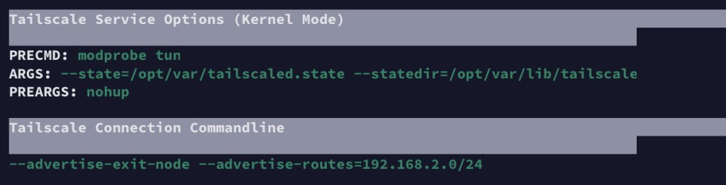

I switched both to kernel mode to no avail. I also deactivated the exit node (I only use it on demand, each network should use its own local internet and I only want the devices to have interconnectivity). Could it be that tailmon is blocking me from changing the setting with tailscale set command? When I tried to deactivate exit node with set --advertise-exit-node=false didn’t change the connection command line in tailmon until I set the option for exit node inside tailmon to no.

From your screen shots you still need to set --accept-routes. I've been running two routers site to site all afternoon using kernel mode without issue.
I looked into userspace mode and as far as I can tell full LAN2LAN will not work in that mode. While a Linux node in userspace mode will accept and reply to incoming traffic it cannot send traffic to the other LAN. This is sort of implied in the official documentation. All the LAN2LAN examples are using kernel mode. Userspace mode completely replaces the network stack so the normal Linux routing methods do not apply.
if you are referring to the “Tailscale connection command line” I’ve noticed that whatever I set in the terminal (for example tailscale set - - xxx) it would not reflect and be updated there. But if I run “tailscale debug prefs” it will show what changes I have made. Do you think my settings are not being activated when I call them? That would make sense. The question ist how to change this Tailscale connection command line?
Here is an example. When I set a value through the command line and then I do a restart from tailmon it throws an error because it wants to restart without the values I have set so I copy the line and do it outside of tailmon and it works with no error but then when I login to tailmon screen they don’t show
TAILMON keeps a record in it's own config what items you want on your command lines... when you run other commands outside of TAILMON, it has no idea what has been done, and just tries to start/execute what it knows about, or what has been configured. It's really mean for simple use, ie. making your router and/or subnet visible for remote access. When you are dealing with multi-network bridging like this, you're going outside the purview of what TAILMON was designed to do, and would recommend discontinuing use, and focus on your own commandlines at this point, until you have something working that you might be able to replicate into TAILMON for any sort of monitoring purpose if you so wish.
Presumably once all custom tailscale up command line parameters are known to be correct, a tailscale up —reset (per the error messages) outside of Tailmon (just once), followed by the correct command line set up from within TAILMON, would be persistent and work?
Presumably once all custom Tailscale up command line parameters are known to be correct, a tailscale up —reset (per the error messages) outside of Tailmon (just once), followed by the correct command line, would be persistent and work?
Correct! Once you have it configured, and know the right commandlines, you should be able to duplicate those into a custom setup in TAILMON.
