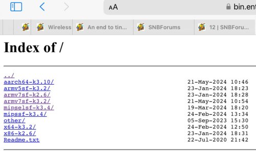

Install entware from within amtm; or repair current install. Please check the armv7sf-k3.2 version is installed during this process.
I don't think this is correct for his RT-AC5300 router. I believe his router's architecture is armv7l 2.6.36.4brcmarm, the same as my RT-AC68U.
Oh 😮. TBH I’m lost on this one, will need to leave it to you. Will remove the references for clarity.
I just assumed there were only two for armv7 devices, i.e. the older (v1.46.1-1) entware packages and newer packages (v1.58.2-1), based on the repository pic below for https://bin.entware.net/.
You're confusing architecture with repository. The k2.6 repository on bin.entware.net is no longer updated. There is an alternative k2.6 repository being somewhat supported at maurerr.github.io.
Ok 😀, all good. I’m definitely not going to argue the toss on this one!
Just wrote that initially as in my test with my RT-AX3000 (yup, different architecture) I watched the messages during the entware install (see pics bit unclear) described above, which downloaded from the k3.2 repository.
I thought this was correct as you referred (above) to the k2.6 repository being out of date. I’ve got no idea if or how repository relates to architecture. Anyway as I said I just removed it completely to avoid confusion. All 👍 good!
