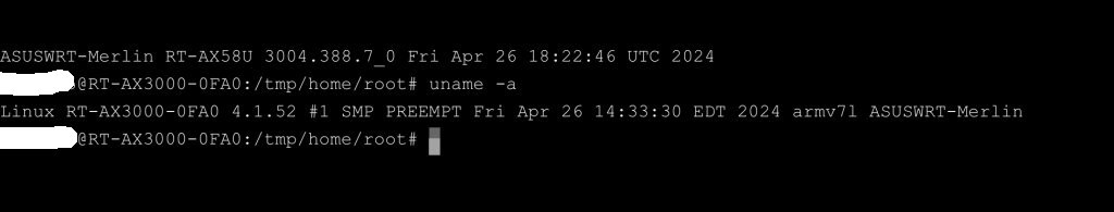

Greetings,
Love the work that you have done, however I have an issue I am trying to solve. When I install Tailmon I get an error: Illegial Instruction. I have tried installing through amtm and installing manually but haven't been successful. I have an RT-AC5300 running 386.9. Let me know what you would recommend I try.
Thank you and I look forward to your response.

From your screenshot it appears you have the exact same issue as ohnngi had above.
If you look at the upper part of your screenshot it refers to installing Tailscale v1.46.1-1, which is an older version of Tailscale, that the older version of entware on your router has installed. The error therefore appears to be due to you running an old version of entware, with an old version of Tailscale that is not compatible with TAILMON or commands it configures.
If you uninstall TAILMON AND then uninstall entware (from amtm), then install entware anew, then install TAILMON again, you should see the same Tailscale v1.58.1-2 install as ohnngi. After that, just configure it (unless you selected express install) and simply update Tailscale to 1.66.4 from within TAILMON.
The underlying issue is the old version of entware (and the version of Tailscale it installs) on your machine. Note that uninstalling entware may affect other addons (will affect those that depend on it) but hey, it’s time for an update :). Note also that per the thread referred to by Colin in the post above, attempting to "update" entware from within amtm does not work. The analogy given by the dev for amtm is that attempting an entware 'upgrade' (as opposed to a fresh install) it is akin to a Win32 to Win64 Windows upgrade i.e. better start from scratch.
Let us know how you get on.
