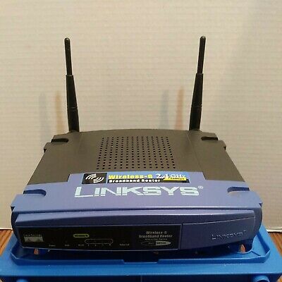

We don't want to go too current here. If we do, then the congestion will impact the performance. No one uses wireless G networking anymore, so my guess is that the congestion will be minimal to none. That is some great future proofing if I ever heard of any!
You have a point. Wireless-B router may even restore the piece on the Wi-Fi battlefield.
End of Life - means for neighbors' routers. They will surrender in 1h time. Happy life after.
