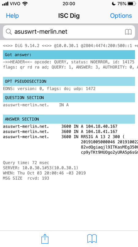

So if folks decide to use Unbound...does DoT have to be disabled?
Assuming you're talking about the built-in DNS Privacy with Stubby (and not Unbound's own DoT capability), it probably should be disabled to save resources on the router.
Probably the biggest adaptation still needed is to disable DNSSEC in the GUI so that dnsmasq is not doing its own DNSSEC, but only proxying whatever Unbound will return. The current dnsmasq.postconf posted doesn't yet address this possibility.

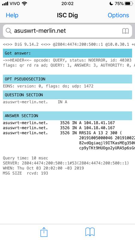

Another point is to check if IPV6 is also listening to unbound.

I am not using Diversion or Skynet to further study unbound behavior
Test unbound with IPV6 queries from clients on lan, wireless.
Reduction of response time.
