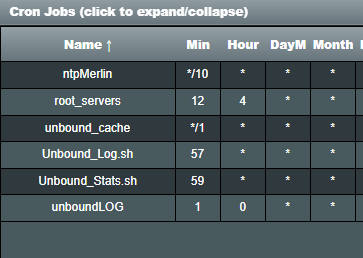

It works, but somehow it wont work after reboot. Cron job disappears after reboot. Any tips?
BEFORE:
AFTER REBOOT:
