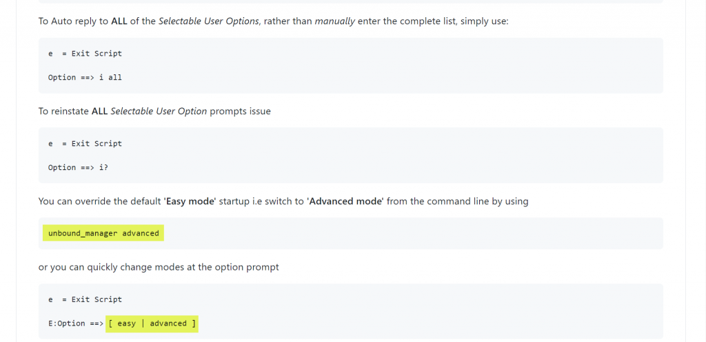

There is a link in Post #1 to the Github unbound_manager 'Read me', and if you scroll down you can see two methods providing instructions on how to switch between 'Easy' and 'Advanced' menu mode
I've never been able to switch to advanced mode using this method. When I type easy I get this:
e  = Exit Script [?]
E:Option ==> easy
Easy Menu mode ENABLED
When I type advanced I get this every time:
e  = Exit Script [?]
E:Option ==> advanced
    Invalid Option "advanced" Please enter a valid option
Am I doing this wrong? I can successfully get to advanced mode via "unbound_manager advanced" from a command line.
