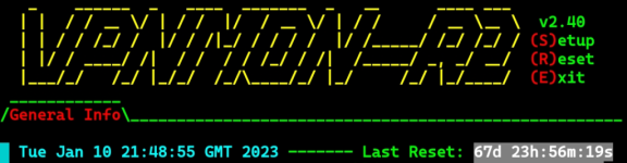

Any idea why the reset isn't working?
How often are you resetting? Do you have any cron jobs performing any resets? When you hit the r key does it perform a reset? What kind of router are you running? What version of Merlin are you on? Sorry for all the questions but I just don't have a lot to go on ;)
