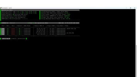

First time looking at this, Is this right? does the VPN custom config file need to be changed?

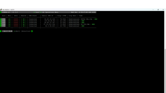

1. It's kind of concerning that if this is very first time you've run this, that it somehow knows your VPN 1 slot has been going 2500 days. That's really weird. If you press the "1" key, it should reset that connection, and reset the time with it as well.
2. Also, it doesn't seem to be getting any city exit information. Can you make sure you're not blocking "https://ipv4.icanhazip.com" ?
3. For each of your VPN slots, you can just add all the Nord VPN IP's to a server list for each particular slot if you want to randomize where it connects to next... or you can just keep it to 1 IP that it will just keep connecting to. I created some documentation here on how to automate this more: https://www.snbforums.com/threads/v...list-generation-tutorials-and-examples.88022/
For instance, my VPN1 slot randomizes against 2382 US-based Nord Servers... my VPN 5 slot randomizes against 86 AirVPN US-based servers. Each night it refreshes these lists to ensure they're up-to-date, and whitelisted in Skynet.
Let me know what specific issues you may be facing?

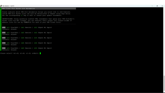

- Under "Edit/R(U)n Server List Automation" I've inserted the AirVPN curl commands for each of the slots, e.g.:
curl --silent --retry 3 --connect-timeout 3 --max-time 6 --retry-delay 1 --retry-all-errors https://airvpn.org/api/status/ | jq --raw-output '.servers[] | select(.country_name=="Netherlands") | .ip_v4_in3, .ip_v4_in4'

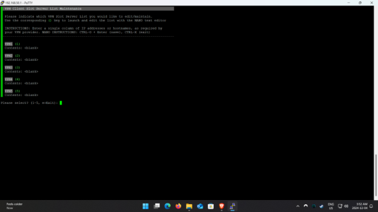

But for each of the slots in the Ops Menu I see [0000] under Svrs. What am I doing wrong -- do I need to also populate "Update/Maintain (V)PN Server Lists"? Was under the impression it would auto populate here using the curl scripts?
Congrats on getting that CURL statement correct. I tested it, and it brings back results. In order for the "SVRS" item to show more that "[0000]", just hit the execute command on that same screen. So for instance, on slot 5, you would hit "x5". It will show you the results of the query and tell you how many servers are now assigned to that slot.

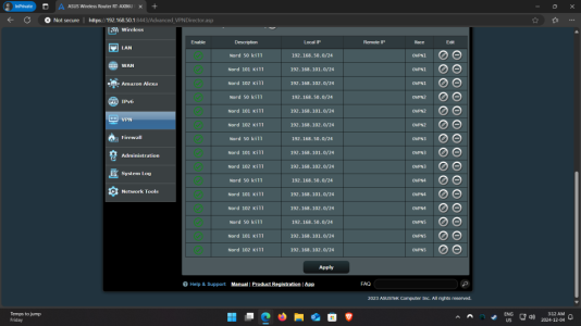

At the moment I have 1 device that has to be routed through the VPN. Number of devices will increase, but for now it's only the one. All other traffic on the network goes out through WAN.
So, I've setup a rule for each OVPN interface to target the device on ...200 -- ignore slot 5, it's not active as I plan on using it for Unbound and DNS like I've seen on another post of yours ;)
Thoughts?
Damnit, missed that. It works!

Personally, I think what you're doing is a bit overkill. You really just need 1 VPN slot set up for this particular scenario. For instance, on my end, I have all devices in our entire house going through VPN slot 1, and a select few are excluded which hit the WAN directly.
