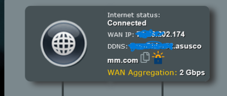

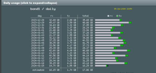

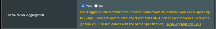

Would love to see a screenshot of what you see on your network map page if you would be so kind. I've never seen a setup with LAG before. :) But yeah, I'm not even looking at any LAN ports, just the WAN statuses... I'd be curious to see what NVRAM values are being populated for these "bond0"/"bond1" connections? Would you be willing to share some of your output by running:
nvram show | grep "bond0"
nvram show | grep "bond1"

Here are the screen shots & files you asked for. Let me know if you want to see anything else.
  • Bond1&0.txt

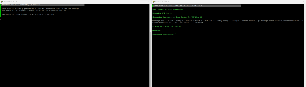

Few comments to -reset behaviour on VPNMON-R3 - v1.04b2
1. when using -reset switch there are sometimes situation that VPNx stays disconnected after switch routine finished. Mostly VPNs are all connected after -reset finishes.
2. Also, when -reset is started, the countdown continues until the end of the cycle (even the WAN check continues), shouldn't this countdown stop right after -reset is started?

I've noticed that sometimes VPN slots need a few attempts before they finally connect. Sometimes they say "authentication failure", other times their public IP is "unknown", all requiring a subsequent reset. Still working through some of this to see if anything can be done about this.
Right now it just checks to see if a reset is happening at the end of the cycle. Good suggestion... I'll check for it during the cycle, and have it exit out to the waiting screen.
I seem to recall it was the same in R2, checking during cycle, wasn't it?
