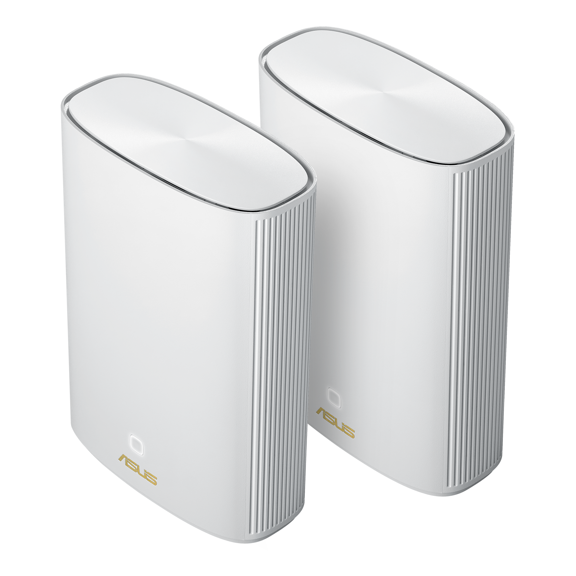

I need to build up a wireless network for a very large home - 16k sq ft if not a bit more. I know I can use Asus routers and AiMesh to cover the entire property like the owner wants, TP-Link and just put the endpoints everywhere, and so many others. The property is single story, with cement/rebar walls, and the walls are thick. At present, there is no wired infrastructure for CAT-5e and I don't know if the owner would want to go that route for wired backhaul.
Budget hasn't been set yet but I imagine they wouldn't veto spending a few k on it if I could justify it. She is also going to want to put Sonos speakers throughout the house.
