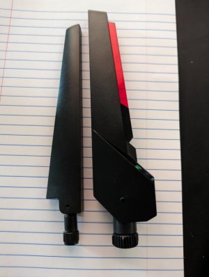

Colleagues, greetings! Someone found an opportunity to buy a new antenna for the Antenna for ASUS ROG GT-AX6000 router. The antenna is broken and I can’t find it myself. I would appreciate your help.
Get me a set of eqivalent-spec "plain" antennas and I'll send you mine. Just a month or two old. The only part of the router I can visually do without...

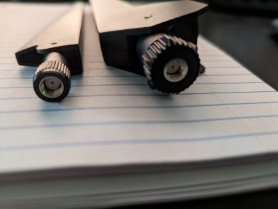

Picked up a unit off ebay and one of the antenna cables is sheared in two at the base so the spinner part is separated.
I have a few Netgear R7000's I no longer use but how does one know if they are 'equivalent-spec'?
I can take them apart and see how close they are in length if that's the real measure.
Most home routers have similar low-gain dual-band dipole antennas. The actual antenna inside the "gaming plastic" is about 50mm long, usually 2-3dBi. You can check FCC data for exact specs. Don't attempt taking antennas apart. The plastic is most often glued and you'll destroy it. There is nothing interesting inside anyway.
Thanks. Will do some reading on the FCC side. The R7000 antenna pulled out pretty easy (just had to pry to rotating pins from the casing) but the GT-AX6000 does look like a true two piece that would require destruction. But since it's junk anyways... :)
