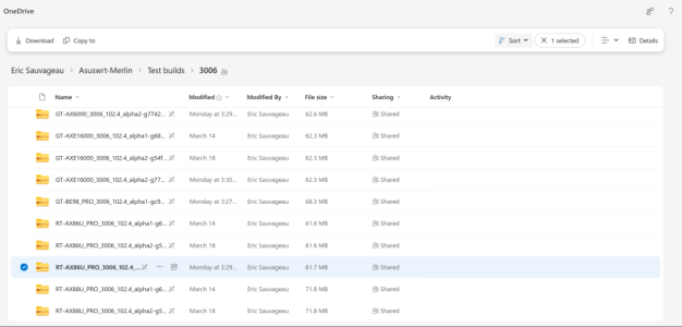

There is, look again.
cant see it lol
Look in the pre beta test builds:
BE86 is not there despite all your screenshots.
I would cry elder abuse, if you weren't correct!
Got up and put on my old man glasses, so I could "see" my incorrectness.
Waiting patiently for beta, so I can jump in with the new features.
Can a brother get a sweet taste of that Guest VLAN?
looks here
