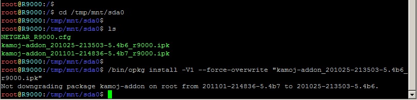

I wanted to bring it back to the previous version but ......
You have to add this to downgrade:
--force-downgrade
BUT be aware that you might destroy your router firmware.
You MUST remove previous add-on before installing another one:
/bin/opkg remove -V1 --force-remove kamoj-addon
Now you have been warned.
