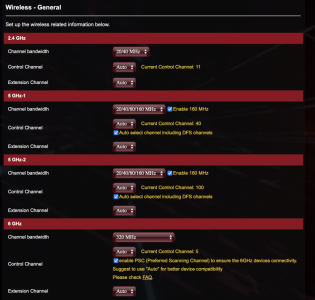

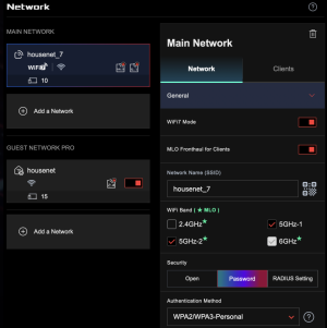

Happy new year all. Finally got 10Gbps internet here at my house and I do get solid speeds on the router at around 9Gbps. However, on Wifi sadly only around 1.5Gbps using an iPhone 16 pro holding the phone 50 cm away from the router.
I do have smart connect and MLO enabled. Also sharing my settings via screenshots attached.
Questions:
1. Channel bandwidth for the various wifi bands (2.4GHZ, 5GHZ, 6GHZ) looking correct?
2. Anything I can optimize on smart connect?
3. Any other recommendations?
Thanks a lot.

1. Channel bandwidth settings look good in my opinion.
*EDIT* Misread the settings I wouldn't touch the MLO/SmartConnect settings...

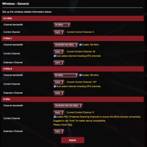

ok let's restart the conversation here - I spent the last couple of days testing and so far I am happy with the setup. I made some additional changes based on @Tech9 suggestions.
However, want to use the opportunity and share my draft final settings version with all of you for future reference.
Location: Asia
Area: Highly crowded condominium with very strong interference from neighbors
High speed ISP: Fibre & Cheaper
Smart Connect: Enabled for now
IOT devices: Separated to a dedicated 2.4 GHZ band at 20MHZ fixed
Logic: 6GHZ for highest bandwidth clients (even that I might not have them today), 5GHz-1 for high bandwidth clients, 5GHz-2 fallback band to reduce DFS hopping or interference issues, and to accommodate any older or less demanding devices.
Screenshot - Wireless General, Smart Connect Rules and Output.

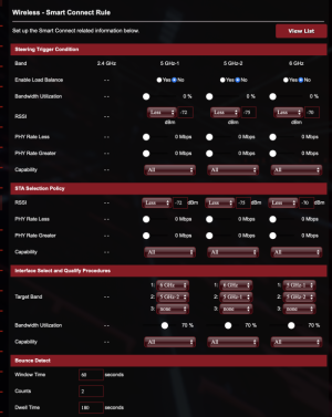

Notes on Smart Connect - changed RSSI and Bandwidth utilization. Logic:
-70 dBm for 6 GHz because it loses strength more quickly through walls, so devices must have a stronger signal to stay on that band.
-72 dBm on 5 GHz‑1 as a middle ground—still fairly strict, but not so aggressive that devices constantly get moved off.
-75 dBm on 5 GHz‑2 is more lenient, allowing older or weaker devices to stay connected without unnecessary switching.

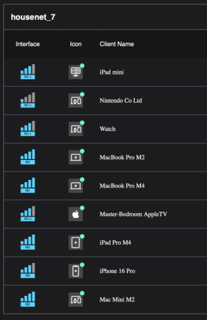

Notes on Output - Looking good in my view.
Notes++ - I did not touch the DFS channels since it is fine for now.
Any comments / feedback please feel free and respond.
Happy new year.
