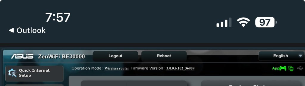

Struggling with Asus ZenWiFi BE30000 aka 3 node BQ16 Pro bundle
Other than waiting for firmware, any ideas?
