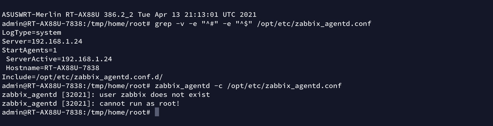

I need your help.
I have also a AX88U. I installed mini snmp for Zabbix but missing information.
I decided to install Zabbix Agent (entware) but I have a problem.
When I start service I have: Starting zabbix_agentd... failed
Zabbix_agentd.conf is ok
I dont' know where is the problem?

Please, show us how is your configuration file.
Also, try starting Zabbix Agent like bellow and posting the result.
zabbix_agentd -c /opt/etc/zabbix_agentd.conf

the screenshot
zabbix agentd
As the error message states, you have not created a "zabbix" user.
You could try two things:
1. Create a "zabbix" user.
Follow the instructions at the beginning of this topic.
Alternatively, the way I do it, edit the configuration files to add a user, as implemented by Merlin firmware. Create the following files with the respective content.
2. Or, you could allow root access for the agent.
For this, open your configuration file.
vi /opt/etc/zabbix_agentd.conf
Add "AllowRoot" parameter.
AllowRoot=1
And try starting the agent again.
/opt/etc/init.d/S07zabbix_agentd start
If you wanna try, my installation script does that automatically. But make sure you removed previous installation of Zabbix Agent and its configuration.
Check it at GitHub.
Many thanks Markfree.​
zabbix agent works
i have create à user but but not working, but with AllowRoot it’s ok
