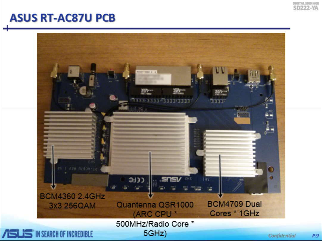

I ripped it off and replaced it with thermal paste on all three heatsinks.
Just from the CPU, it was running at 84C normally and since I replaced the thermal tape it is now running at ~70C.
If anyone is running into a heat problem and dont want to go with laptop cooler fans, I recommend replacing the crappy thermal tape.

Really do not know if there's heating problem, or if this is a problem of this router. My router is on 24 hours a day and did not notice heating problems. I live in Sao Paulo city, Brazil, and in thisweek has ambient temperature of 36C, and had no problems.
I believe some units have a heating problems, not all.

This is what I am getting with laptop cooler, I wonder if removing the tape would help me at all???
Is it hard to do? Can clips or ?? be broken? Or is it straight forward?
Also can you post a link to some great thermal paste (amazon?)
The only reason I am thinking about doing this, is heat in the summertime for me, and many others. I know once the firmware is great, this router will be the best of the best, now that we know heat with these is a major issue, maybe not at first but if not addressed the router will most likely prematurely fail. At this price we all paid at least for me, I can not throw that kind of money out every year. Especially if I can not sell it as used, in good working order.

I used some arctic silver 5 I had already on hand for the thermal paste. It wasnt too difficult to remove the case. The front has no clips. (the front being where the LEDs are) I probably should have taken some pics; but there is one clip on each side, and I believe it was either 4 or 5 clips on the back.
I pried it open starting from the side using a plastic pry that looks like a guitar pic. you should be able to do it with a credit card as well for a pry. The clips they use are the same they have used for all of the asus routers; there should be some pics around for people taking apart the N66u to use the internal sd slot.
The heatsinks are held on with simple plastic clips with springs, using a simple needle nose pliers to squeeze the end together is what I used to push them through.
The reason I said the thermal tape is garbage is because after removing the heatsink; I could tell that the actual contact being made between the heatsink/tape/cpu was about the size of a pencil eraser. Now the heatsink has full contact. I might have gotten away with just pushing the heatsink on harder to make sure there was full contact, but paste imho is just better.
I found this image.
I assume the clips are around the heatsinks, your remove them, lift off the heatsinks, then remove the el-cheapo thermal tape underneath.
I have Artic Silver lying around I believe I can do this same as with computer CPUS.
http://i146.photobucket.com/albums/r254/maylyn22/ASUS RT-AC87U/PCB-1.png~original

So basically just the cooling pad is good enough it seems from the tests.
voiding warranty for a maybe 3 degrees less (on the cpu, not the 5GHz chip yet) does not seem worth it

For me to only achieve such minor temperature different isn't worth the hassle. Moreover it's just the CPU core temperature.
Just adding a laptop cooler to the router is good enough to see significant temperature drop throughout all 3 cores.
Or maybe my technique of applying the thermal paste is wrong. But I'm too lazy to try it again any time soon.

Mine was a 14C degree change from the pads to the paste.
