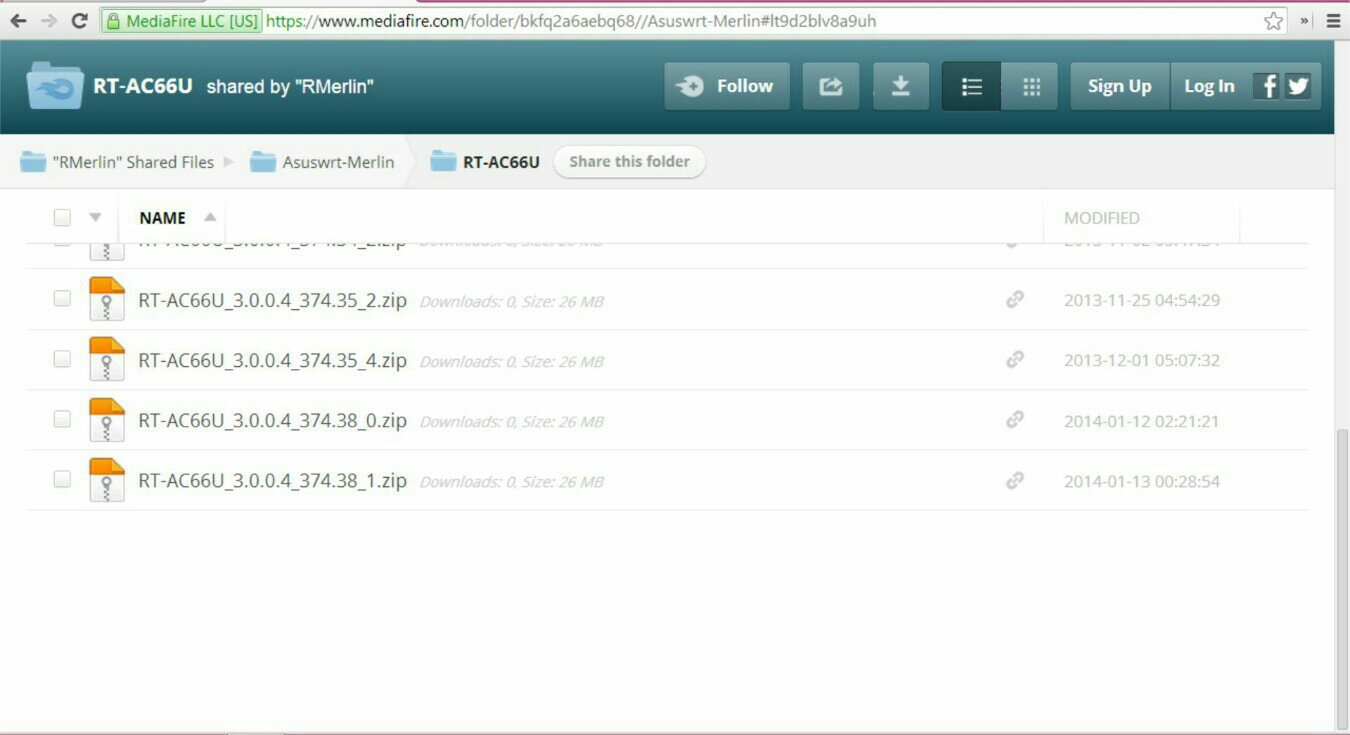

not sure if its been asked elsewhere, but the 3.0.0.4.374.38_2 build is missing in the AC66U folder for official downloads. Is it not the latest build for the AC66U?
Sent from my Nexus 7 using Tapatalk
Look again, it's definitely there.
