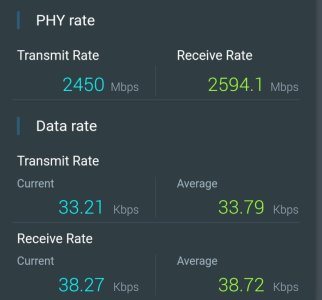

Dirty Upgrade - GT-AX11000 & RT-AX58U - Successful no apparent issues. Did notice under AIMESH I can finally see PHY rate on my node. Haven't seen the info populated since stock fw.
2.5Gbps PHY rate on 160Mhz.

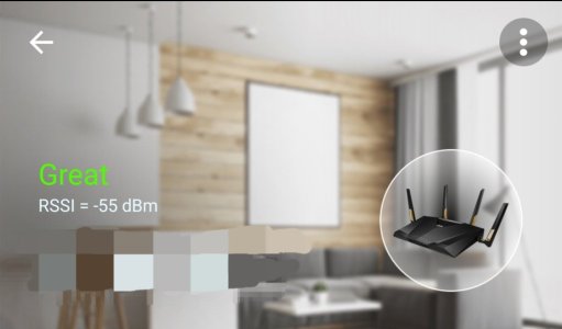

Another thing, in previous version, for me anyway, the RSSI was way worser (-58 / -62 dBm).
The ram got about 54-55%
No addons or any TRAFFIC ANALYZER of sort are enabled.
Currently standing on 48%
After 15-16h, it is initially look way better starting point.
Hopefully it will remain the same.
