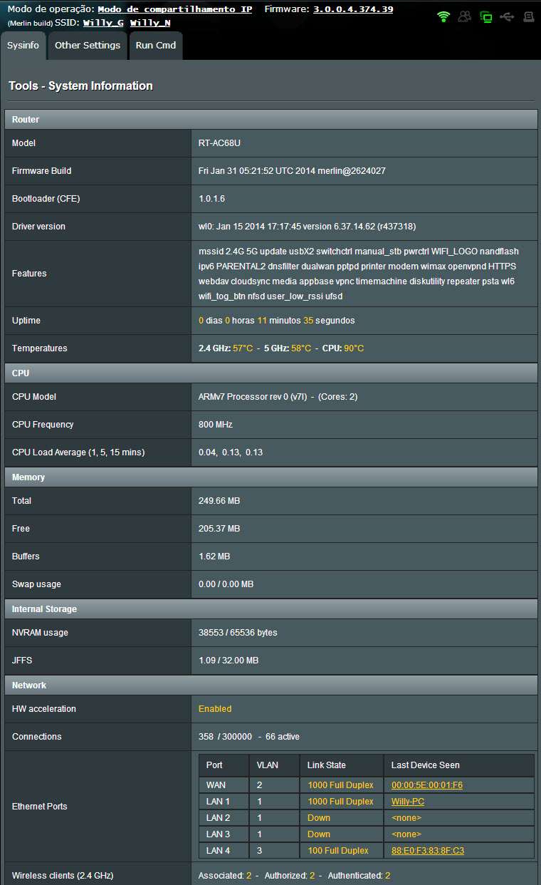

But i saw the overclock feature, and it`s not working for me :( , when i click at the back button at my 68U it freezes and i have to disable the OC and reboot it, would like to enable the 1000Mghz, is there any way?
Another thing, about the JFS partition, can you take a look if everything is ok in my system? i saw in the admin section that i can format this one, should i?
Here is my 68U system image, let me know about the OC and the system if everything is right
@Merlin, can you check for me?
Thanks guys
