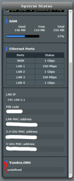

@RMerlin Regarding status page - it now shows along with Wireless status? Wasn't it connected to Internet status before?
And also - why Yandex.DNS at bottom? I never, ever configured anything regarding Yandex on the router.
I know it has Yandex Family and Yandex Safe for DNS filters, but i swear i never touched them.
