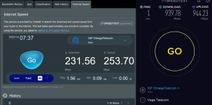

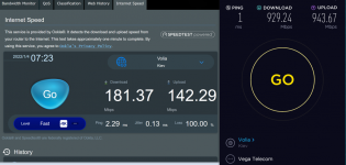

hi everyone, why the speedtest results so different from the router directly and app? (AC68U)
