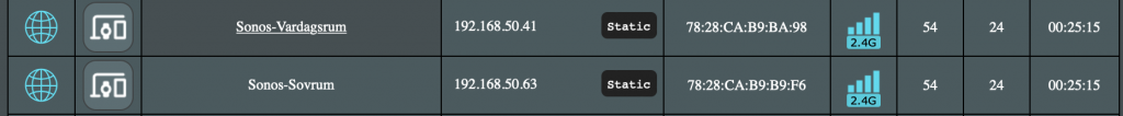

Hi guys,
Recently dirty upgraded to 386.4 from latest stable
AX58U.
So it seems like i have the same issue with 2.4ghz devices that some others have had.
My sonos speakers is connected to the internet but i cannot access them from any other device or access them through the browser.
So it looks like they're connected to the wifi but with some kind of failure, Any suggestions?
2.4ghz settings covered in the pics.
Skärmavbild 2022-01-08 kl. 11.45.18.pngSkärmavbild 2022-01-08 kl. 11.45.49.pngSkärmavbild 2022-01-08 kl. 11.46.09.png
