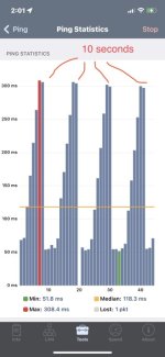

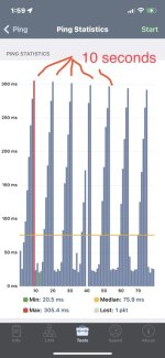

My AX88U (386.8) has some new strange issue where ping times will slowly escalate from ~30ms all the way up to ~300ms, then suddenly fall back to normal.
This repeats every 10 seconds like clockwork.
I'm also seeing issues with streaming video services on the TV that will randomly drop to the worst possible quality level (240p/360p) then slowly ramp up again to 4K.
I have Frontier 1Gbps fiber internet. This is a new issue and was not happening before. The regularity of the ping time escalations leads me to believe the issue is local to the router.
The device sending pings is connected to the main router, not the AiMesh remote AP.
See attached screenshots. One target is facebook.com; the other is apple.com.

Just checked it here,
Apple.com ping is every 10sec gets a timeout, ping to IPv4 address of sort (from Israel, around 60ms).
Checked google.com and facebook.com. both IPv6 address ping and avg of 60ms and no issues of ping spikes at all

Did you try to ping the IP-addresses instead of the URL?

Same here!
ping -4 -t on www.tagesschau.de works without timeouts.
So I think it´s an "applething"....

I got similar results pinging facebook.com, so it isn't just an "Apfelsach."
Pinging the IP makes no difference. The ping utility performs the DNS lookup once at the beginning and uses the IP address going forward (until you ctrl-C to stop it).
Anyway the problem went away by the evening and QoS was still enabled (I had forgotten about it). Still, I will have to see if the problem returns tomorrow. If so, I will continue investigating.
