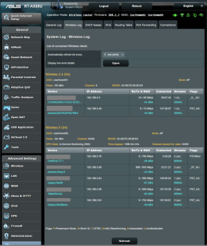

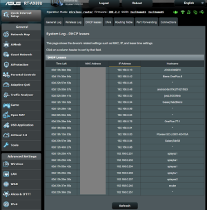

Hey guys anybody else having issues with devices not showing up on the Client Status tab???
I updated to 388.2._2 when it was released, worked fine but recently it only shows 3 wireless devices connected. When I have at the most 8 active devices on wifi?
Any suggestions on this issue?
Thanks in advance.
The Client Status page always was (and still is) a fluffy list of devices - better it would be removed to avoid this kind of confusion.
If you like to see the wireless connected devices you go to System Log / Wireless Log for a reliable information - the rest (fixed line) of devices you can find in the DHCP Leases tab.
Thank for the info.
