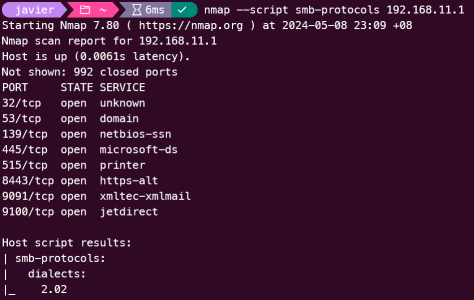

Hi @Viktor Jaep, here is the screenshot from Putty.
That is correct RT-AC68U gives me v2.0. as per attached picture.

The SMB version supported by the router's Samba server has nothing to do with the SMB version supported by the CIFS client module. Do not conflate the two.

Unless there are any other ideas, I think you're at an impasse. The router only support a max of SMB v2.0. The Synology only supports a min of SMB v2.1. Unless there's some way to get your SMB stack to a higher version, your only option is to obtain a newer router. Alternatively, you could see if you can get NFS working, and see if your router and Synology can agree on that standard?

I checked that the credential seems not to be an issue because with SMB v1.0 the handshake process got that far compared to SMB v2.0 not even starting the connection. However, SMB v1.0 is not an option because Synology has dropped the NTLMv1 from DSM7.0 due to security vulnerability issues, therefore Synology drops the connection before completing the handshake, as mentioned in the previous post.
On another hand, the fact the RT-AC68U and the Synology both report to have SMB v2.0 enabled but are unable to connect, makes me think about @ColinTaylor 's comments that the Samba server and CIFS might use different SMB versions.
I tried to check the CIFS SMB version in the router with the below code, however, this will only report the SMB version after a successful connection which is the actual problem to solve.
