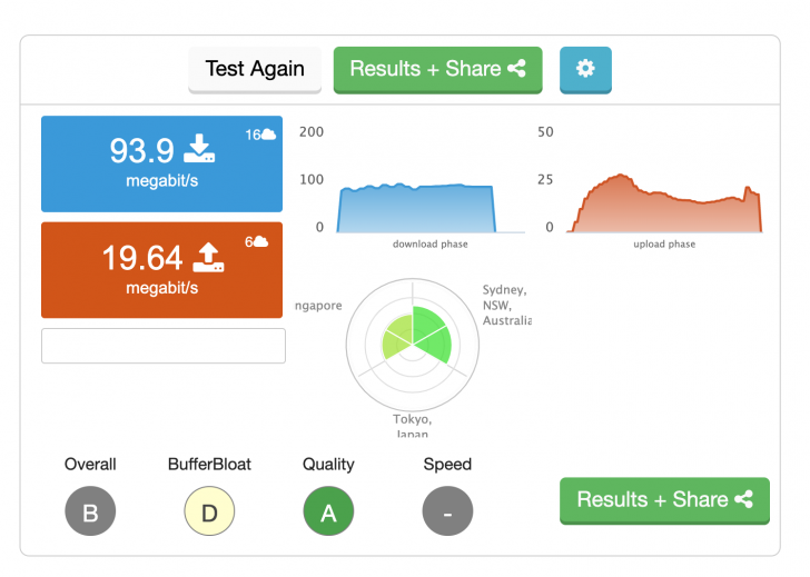

Okayyyy - so I've turned off QOS and ran the following speed tests, what would you suggest I put as the numbers for manual bandwith? (current config set picture provided below). These tests were performed with 'some' internet usage occurring but not a completely dead test (which I thought we had to run to configure the previous numbers).

Your upload in the QOS field on the router needs to be changed. You have 34 but your test show much lower. Ideally you should run this test with nothing else running to give you a good baseline. From there you tweak the QOS settings to be 80-90% of your actual value. In your case I would try 81 for download (90 x .90) and 16 for upload (18 x .90). From there you can lower until you get the expected results. I still recommend running with nothing else or you can try SpdMerlin which is a script @Jack Yaz created. It runs a speedtest from the router itself.
Okayyyyy so
  1. Setting upload to 16 and DL to 81 √
  2. What do you mean:
  3. Do you mean to turn off QOS? Or just set those values that you said?
Okayyyyy so
For now set those values. I was recommending a script that can run automatically that will run a speedtest from your router out to the internet. It can show you your past results in a table and graph. That would help you get a better idea of what your speed really is.
> What I mean by completely dead = when network traffic was very low. below numbers are normal usage (just web browsing etc occurring)
* PS if I know the device that is causing lag should I mark it as LOWEST in bandwidth monitor screen tag or does that do nothing?
Use 95% of both values.
