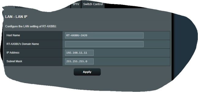

Thanks, I want to make sure I'm explain my setup correctly I have attached my lan ip
Also, when I specified 192.168.11.0/24 as the ip4 range it stated that it was incorrect value. R1 192.168.11.0.24 and when asked for ending range I just hit enter. Also, when using Putty to access router SSH, how do you gracefully exit the script once you completed setup.
OK... so your router is 192.168.11.11... What is the client PC's IP address that you are testing with? This is what you want to change the Single IP to... don't include your router in this mix.

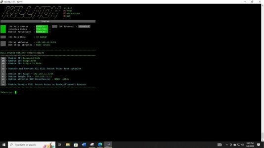

It worked see attached, much appreciated that you took the time to help me. One Question regarding Enable/Disable Kill Switch Rules on Router/Firewall restart, how do I know it enabled, also what would happen if I removed the usb from the for some reason I wasn't seeing all the options that the script uses. That was my problem
Good deal! I would still change your "Single IP" value to something other than your Router IP. Use like an internal workstation that you can enable for testing if you needed to.
You would be able to find a start command under your /jffs/scripts/firewall-start file... as soon as your router restarts and the firewall starts, so do the killmon killswitch commands.
If you take out your USB, you may cripple killmon. It requires entware which is located on your USB drive. Try to find something reliable yet cheap, and keep it hooked up.
